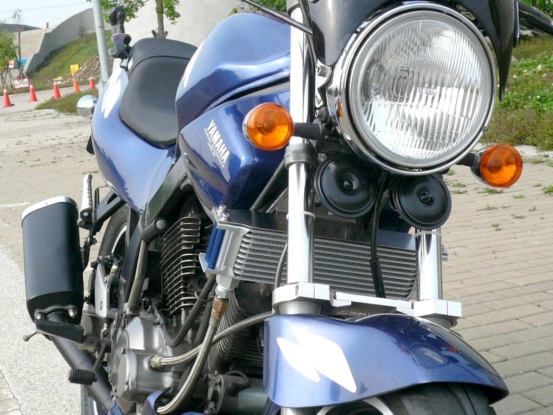

日式油冷排的話5排或7排就夠了,英式的話可以考慮10排或13排(13排比較好看、可是10排就夠了)。:D
底下照片中就是我現在用的,這是英式10排。

回應 7# luca 的文章
that looks really nice! Exactly what I want! How much would that cost? Where can I get it? Where can I get it installed? I currently use 勁 150's oil plate (4 rows, each  about 10 cm wide). I modified my engine to 200ccs and modified my crankshaft. Is my oil plate good enough if I ride like I do described above? Thanks alot everyone.

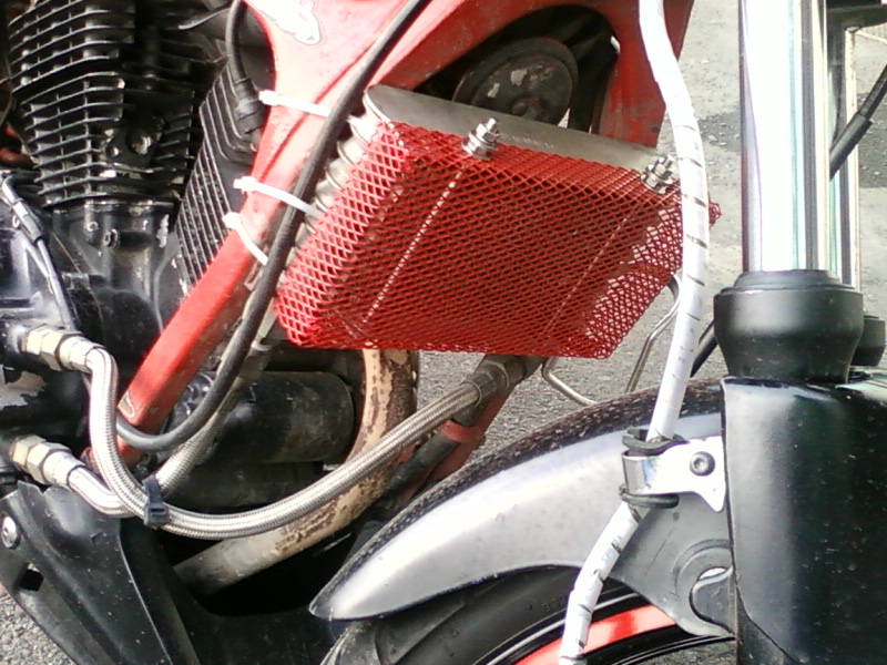

日式七排也不錯用...

回應 8# Slick_Kev 的文章
[ 文章最後由 luca 於 2009-9-19 00:20 編輯 ]
